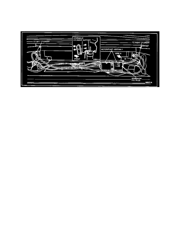

Min cab jobbar otroligt långsamt,både när den skall upp och ner.Har smort alla lederna ,kanske dags att serva pumpen.Hur gör man ,vilken olja och hur mycket ?

Hittade det här, kanske räcker med att bara byta vätskan till en början. Ska tydligen vara automatlådeolja typ Dextron III eller liknande. Brukar stå på pumpen verkar det som.
Convertible Top Hydraulic Cylinder: Service and Repair
Removal
1. Remove the rear seats and quarter trim panel.
2. Remove the hairpin clip, washer, and clevis pin from the upper end of the cylinder.
3. Remove two bolts, attaching piston to the main pivot bracket support, each side of vehicle removing bolts will allow piston to be pulled off outsidestud.
4. Pull the cylinder down; place an absorbent cloth below the hose connections; disconnect the hydraulic lines and remove the cylinder.
5. Install the hydraulic lines on the new cylinder and install the cylinder bushings, mounting bracket, and bolts.
6. Install the clevis pin, washer and hairpin at the upper end of the cylinder.
7. Operate the top assembly two or three times to bleed any air from the system, and check the fluid level in the reservoir. The fluid level should notbe less than 6.35mm (1/4-inch) below the filler plug opening. The top must be up when the fluid level is checked.
8. Install the quarter trim panel and rear seats.
