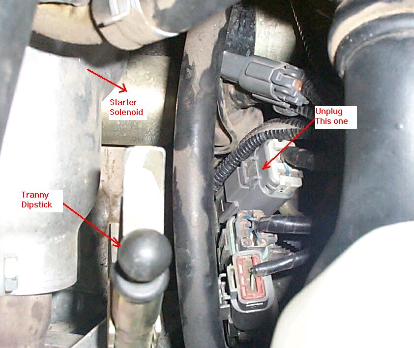

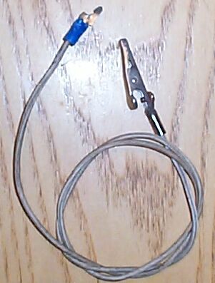

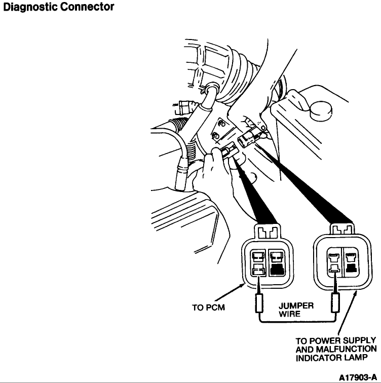

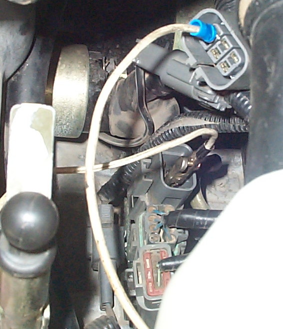

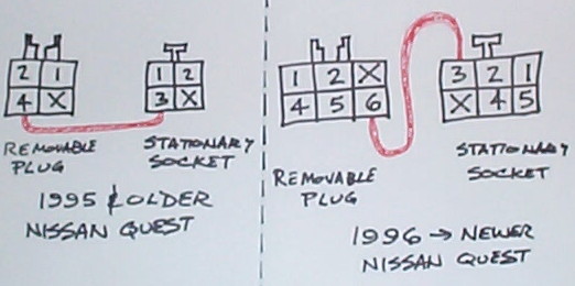

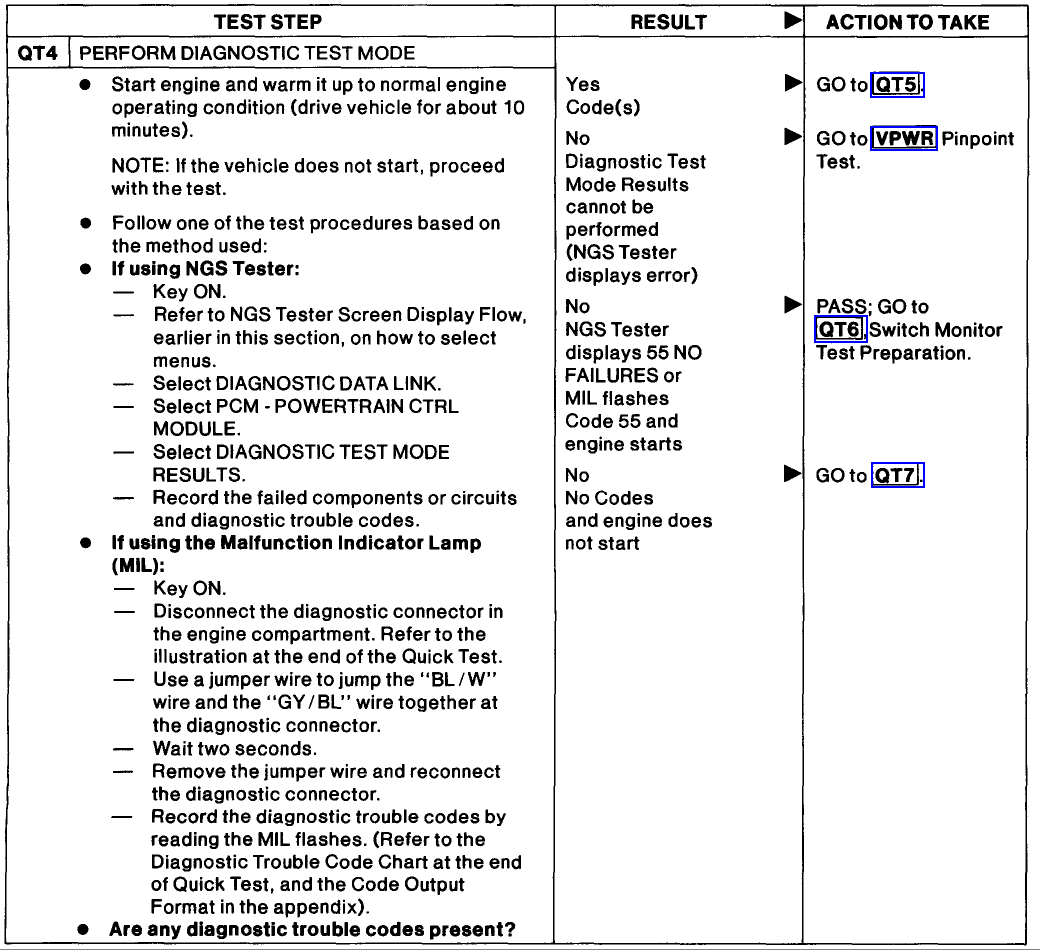

Du kan prova att läsa ut felkoder när du har problemet, om du byglar kontakten till lampan så ska den visa vilken kod som finns lagrad genom att blinka.
Hittade detta:
1. Turn the ignition off
2. Unplug the diagnostic plug nearest the starter solenoid
3. Turn the ignition on but don't start the engine
4. Reference this diagram to determine which pins to jumper
5. Plug the jumper wire into the indicated pins in the plug & socket for exactly 2 seconds, no more, no less, and remove the jumper wire
6. The CEL should start blinking, a series of long flashes followed by a series of short flashes. It will repeat the cycle so don't worry about rushing back to the cockpit to get the codes. When the flash sequence repeats, count the number of blinks for the longer duration flashes, & count the number of blinks for the shorter flashes. This will give you the code, for example 12 long flashes followed by 5 short flashes is fault code "1205" which is the transmission "Line Pressure Solenoid" and/or circuit fault (96 & newer).
